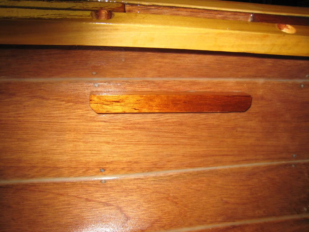

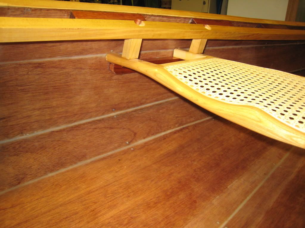

I have enclosed a few pics showing how I have supported the seats in my build. I have taken in the expert advice from other builders on other postings on this site and made up a combination of both a cleat and additional support via the gunnels. As the pics show I think it looks both practical & aesthetically pleasing. I have picked up some S/S bolts, washers and lock nuts to secure them in place, I will then fill the top fixing holes in the gunwales with epoxy.
Hope this helps?

It looks like you've done a good engineering job of spreading the load there, Artful. It would hold even a heavy, clumsy fellow like me falling into it.
