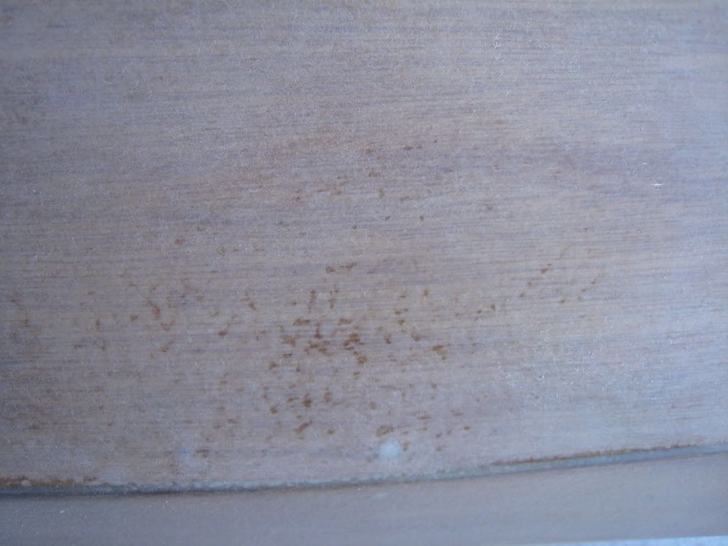

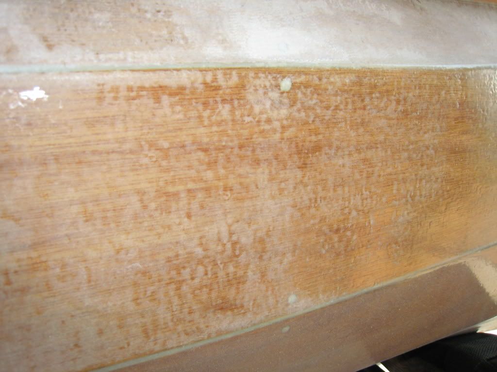

Using a random Orbital Sander (ROS) and 120 grit, I sand all the high spots, lumps and bumps off the top coat of epoxy. I hand sand where the ROS won't go. As you progress, you will see the sanded areas come up dull with lots of little shiny spots inbetween them. I use the 120 grit till all those little shiny spots are allmost gone- or to about the size of pin heads. ( they are low spots in your resin)
Now, I change to 240 grit and remove all the pin heads.
Vacume all the dust out and wipe down with a damp shamois - several times.
Your varnish will only be as good as the preperation you put into it.

Mate, this is what I do.Q2) What if, any, does the varnish coat pick up as far as a filler goes, do I need to have an absolute glass finish before the application of the varnish coats go on?

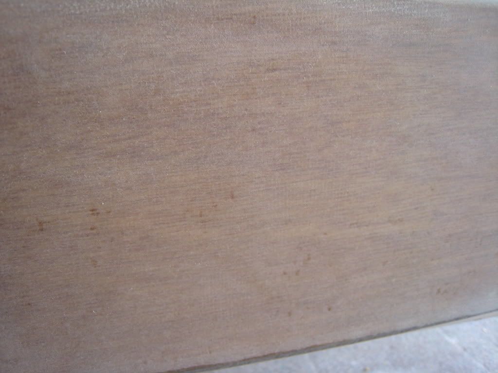

HM,
Thanks for your support I ran off to Bunnings (Walmart) to pick up some supplies to supplement my arsenal.
1) 125mm OSD Grades 60 - 240 grit
2) triangle detail sander 60 - 240 grit
Once underway I continued with your
and come up with the following to which I am
with (see enclosed)

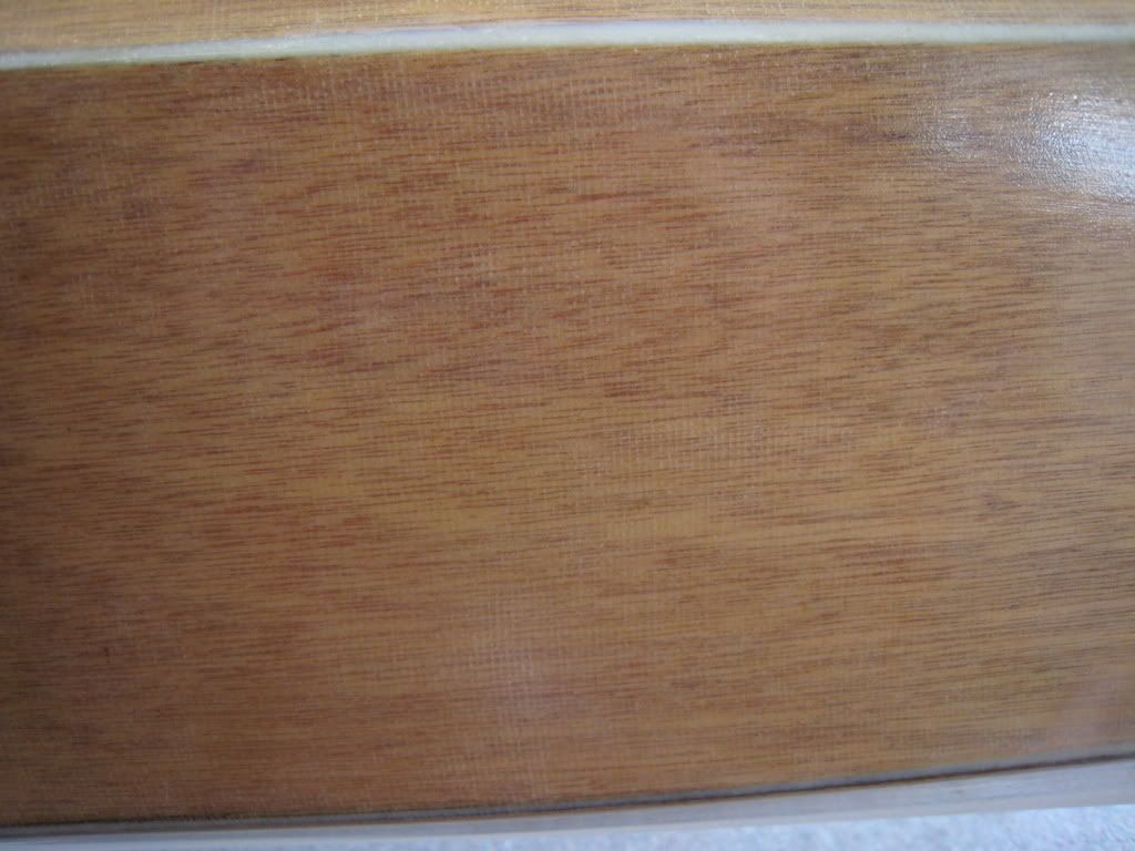

Art,
don't sand any more mate!
Any more and you remove cloth and weaken the boat.
I would use a quality foam roller to apply the varnish, lighty hand sanding between coats with around 400 grit paper
Three coats will probable be enough but more is definately better.
After the final coat, sand back with 1200 grit wet & dry , polish with good auto polish and buff well. (I use a supercheap leccy car polisher) saves a lot of elbow grease.

Correct, yes I am working to the plans that condition light on light off; however I am now convinced that foam rollers are great for saturation and second coat. After sanding back I think the best third and fourth coat application is by brush applied with the best expertise possible, layed off after a set time.
