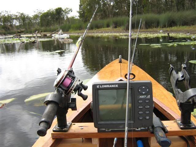

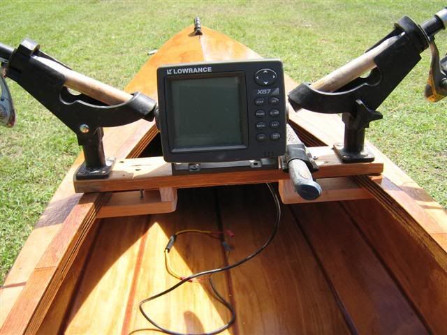

An alternative would be to build a thwart/cockpit which is strong enough to take the rods and can be removed if I'm not fishing and can also be adjusted to optimally position the holders.
